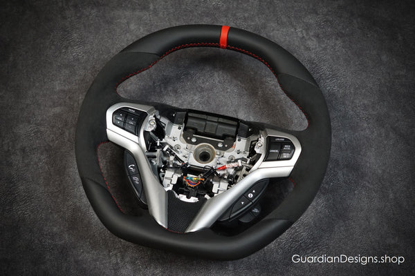

Apparently the only company that made an OE style replacement steering wheel was Lecce. They made all sorts of colors and finishes. But I checked their website and it looks like it’s completely wiped from the internet. That really sucks! But it is a reminder that the CR-Z’s days of parts availability are numbered.
I checked Buyee, and I kid you not, one of the first listings for steering wheels had a used D-shaped carbon Lecce wheel! It was just under $200 too, way cheaper than it was new! I snagged that thing immediately. It seems that the guys who listed it didn’t know it was a Lecce wheel and listed it as an OE wheel. Anyhow, I was super lucky!
