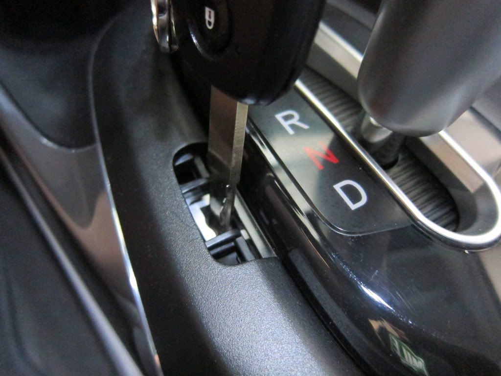

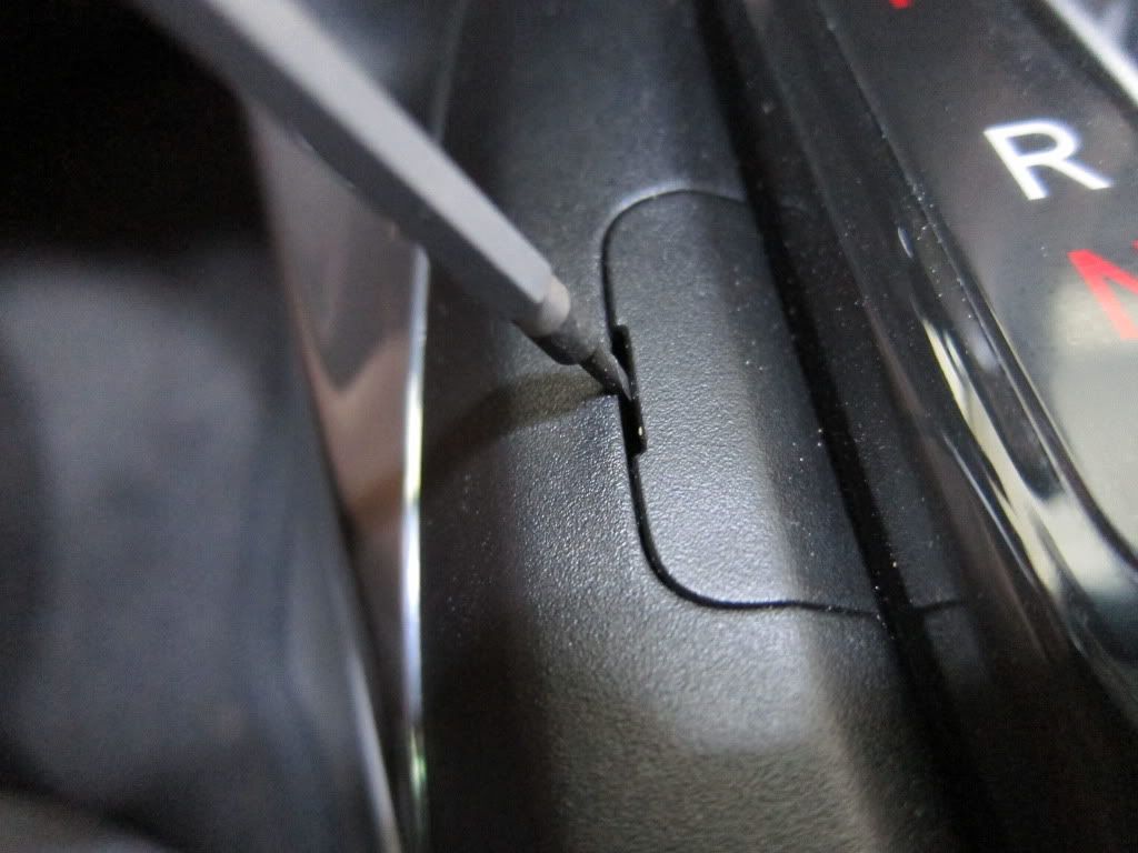

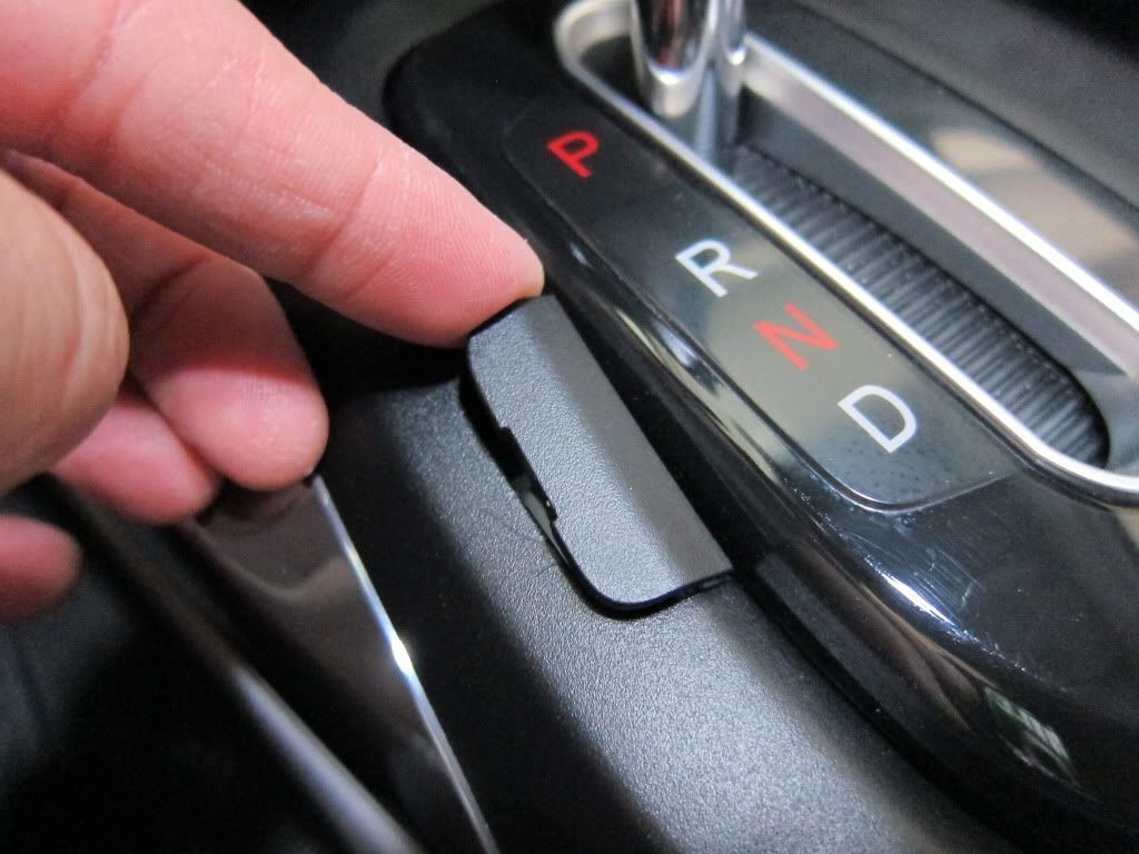

1. Make sure you are on level ground, take the small flat head screwdriver and pry the plastic off the shift release slot:
2. Insert your key into the slot, push down and shift into neutral:

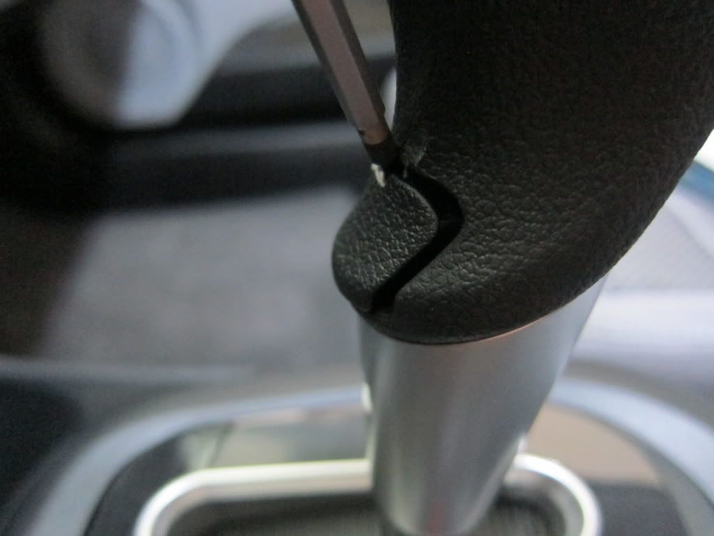

3. Using the small flat head screwdriver again, pry the pleather, (plastic leather) piece to reveal the other screw holding the shifter into place:

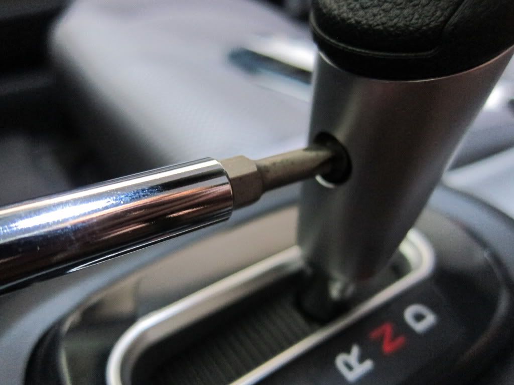

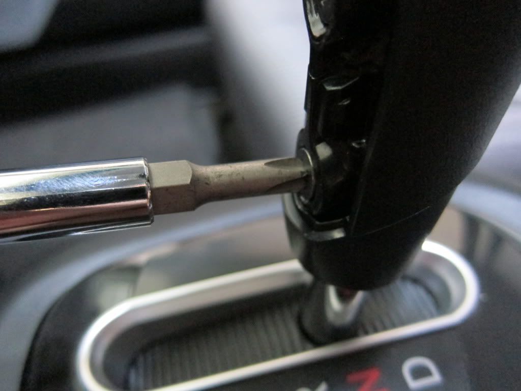

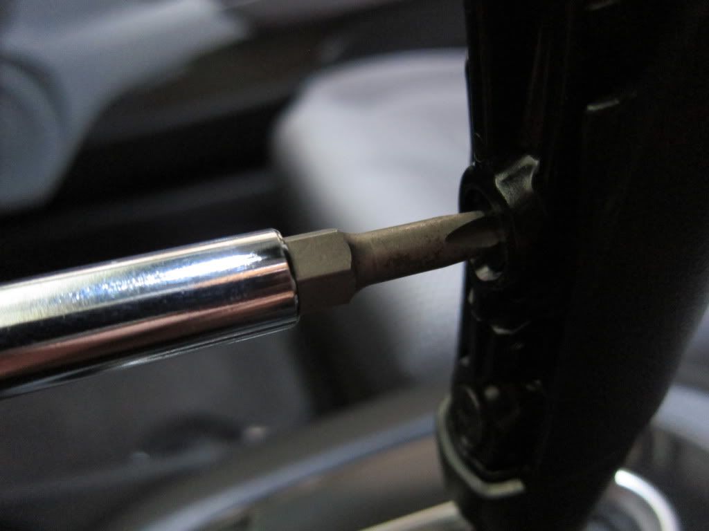

4. Using your phillips head screwdriver, unscrew the two (2)screws shown:
5. Once the two (2) screws have been removed the shifter should be free of the shifter itself. Pull directly upward and it will be free of the shift tree. (It doesn't take very much effort). You will notice two (2) notches on the shift tree itself, this is where the screws will secure the new shifter (not pictured):

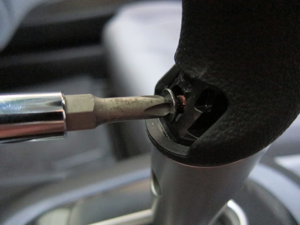

6. Take your new Honda Fit shifter and replace it on the tree in the reverse order. You may test it out by pulling on the small lever shifting from neutral to drive and back to make sure it is working properly:
7. Using the two (2) new screws that came with the shifter, replace them and tighten them down on the tree:

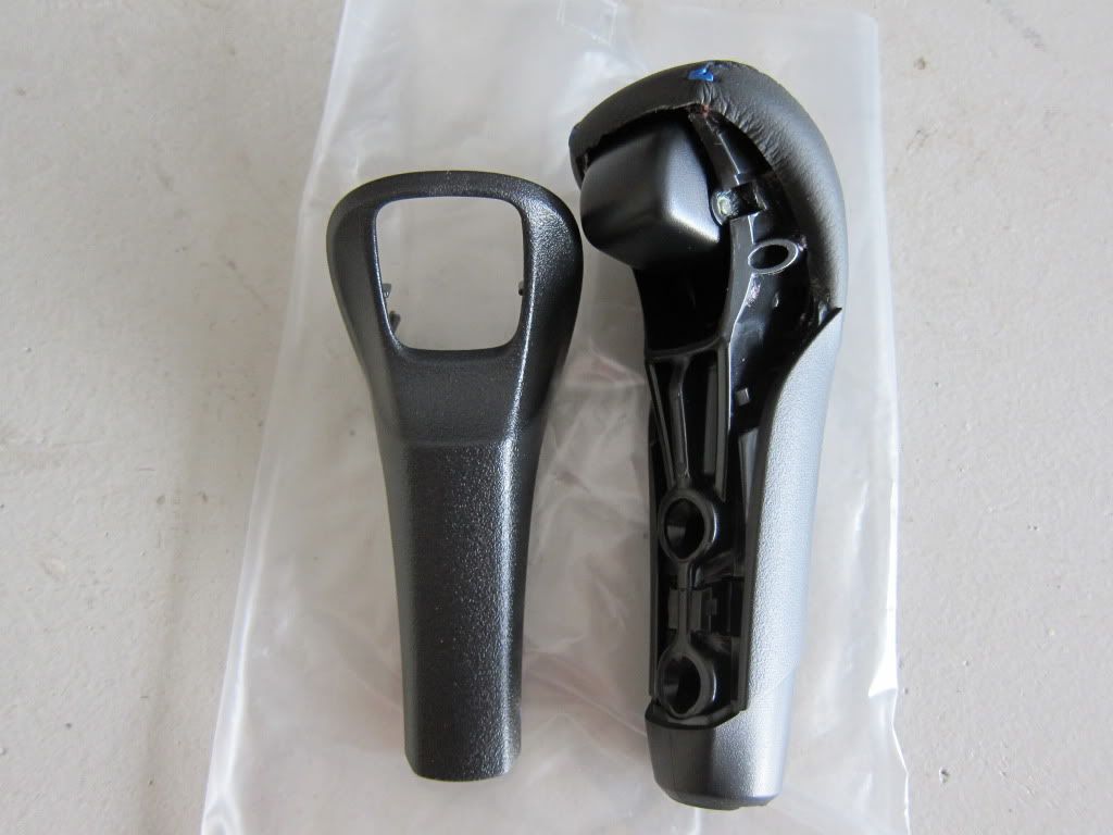

8. Once the two (2) screws have been tightened and secured, take the plastic shifter cover and snap it into place:

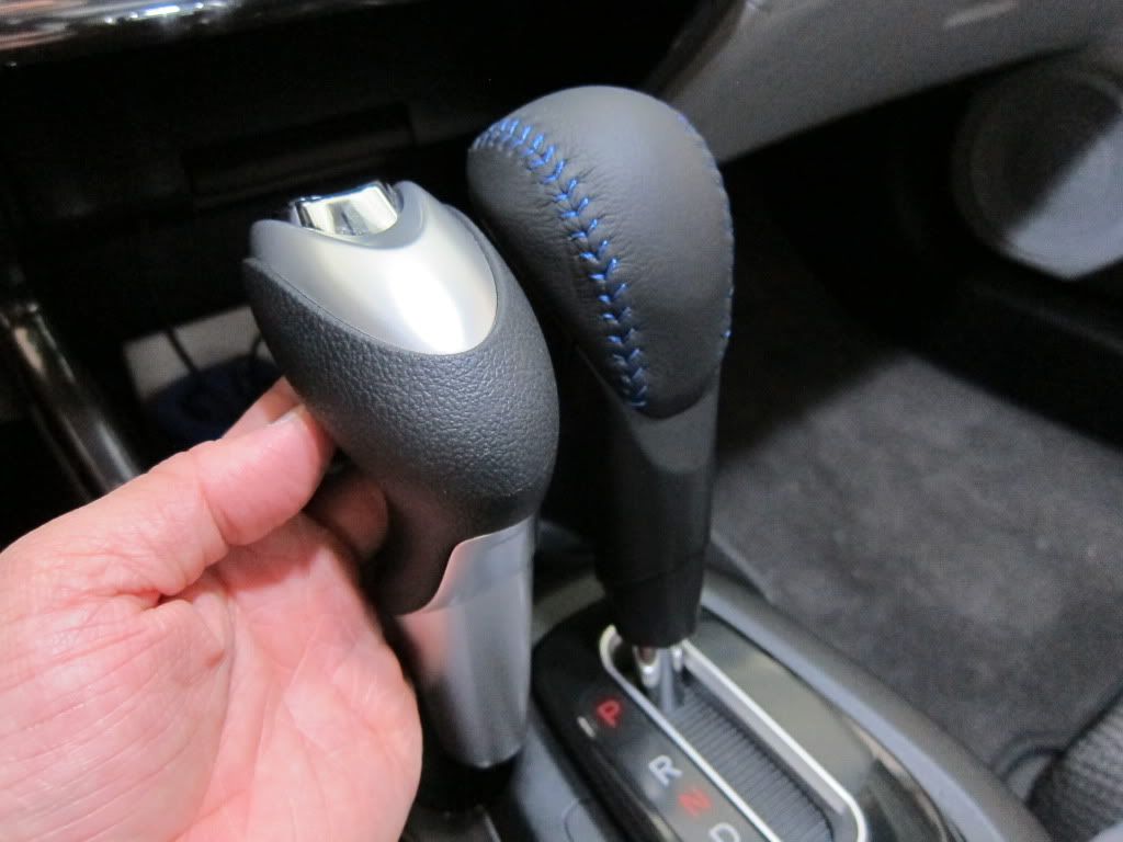

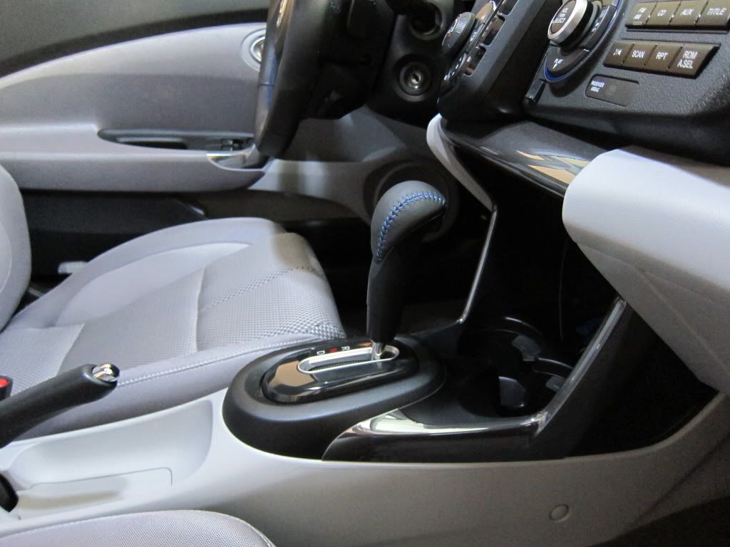

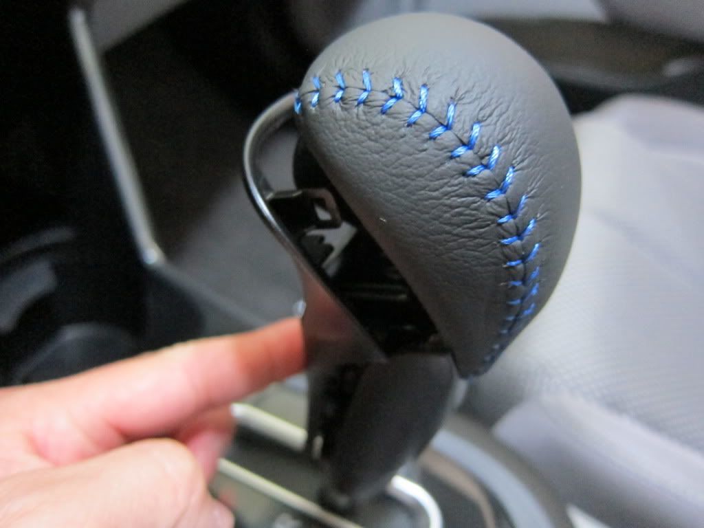

That is all there is to it! Enjoy the look and feel of your new shifter. Here is a picture of the old and new side by side:

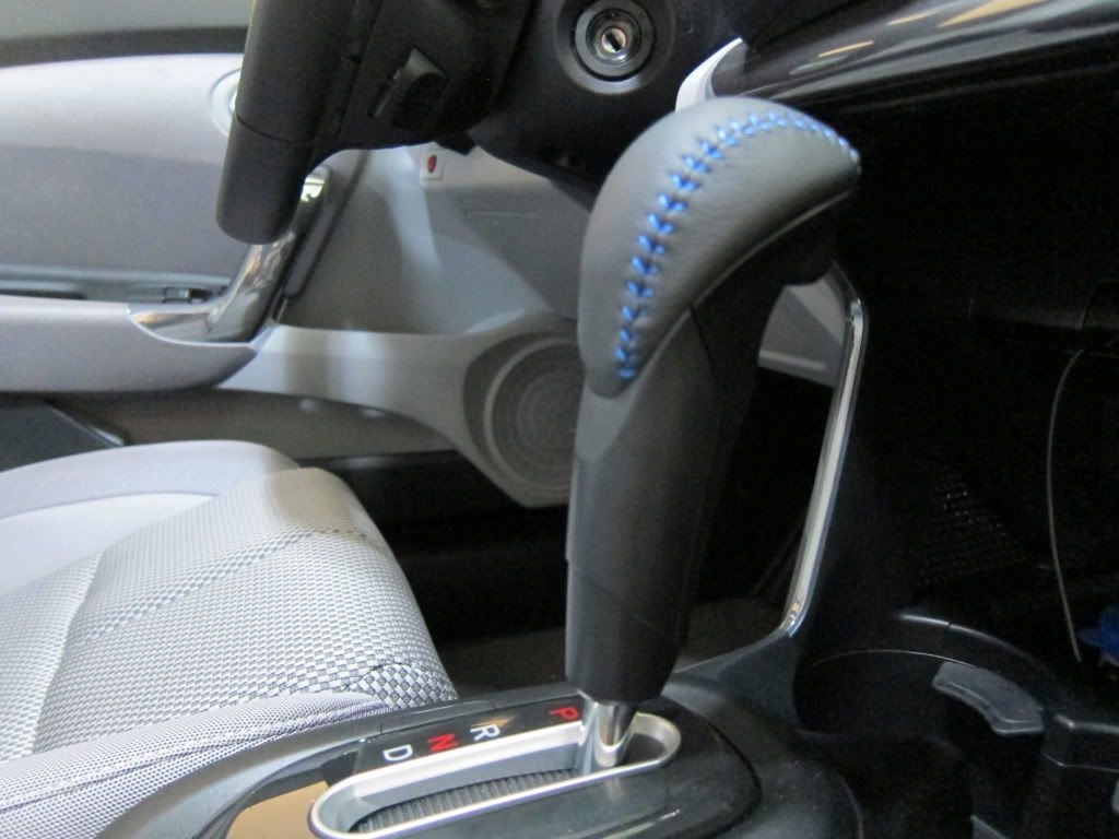

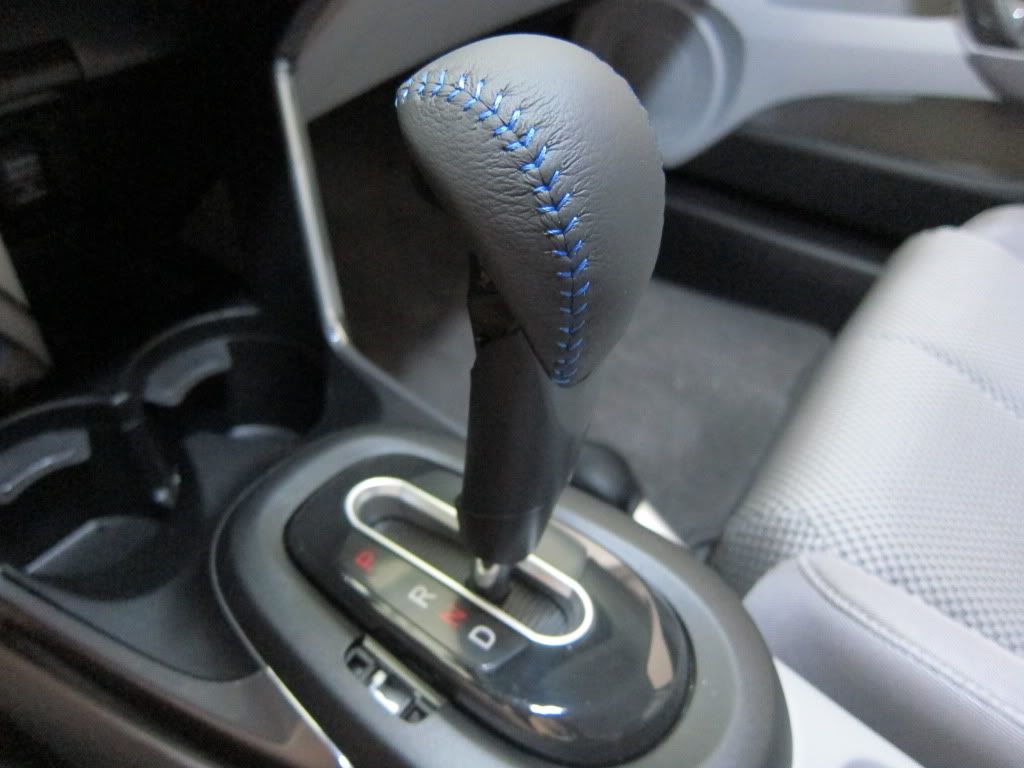

Pictures of the new shifter:
