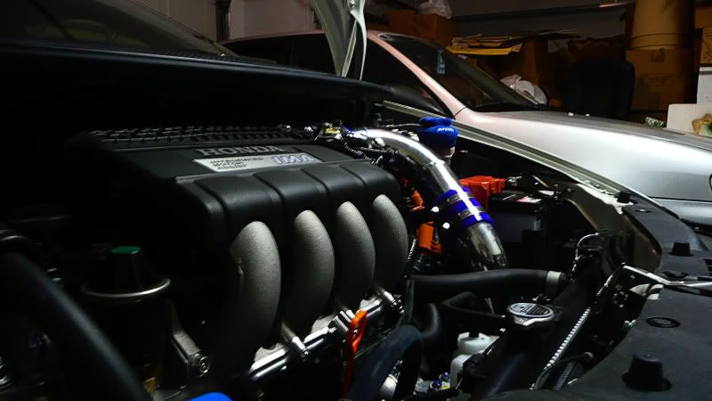

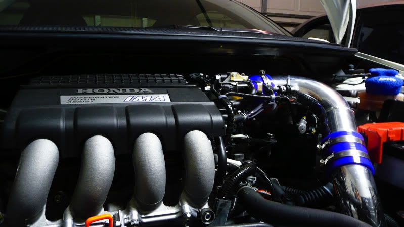

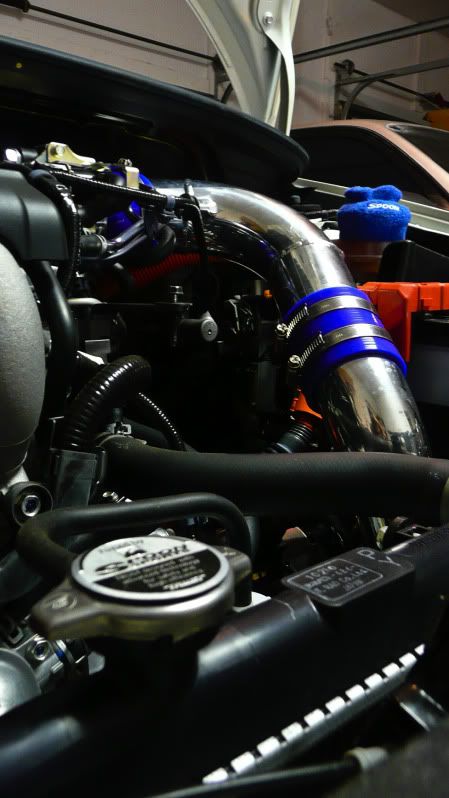

I have had the BLF CAI for a little over 2 weeks now. It is really a great intake. When I first got the intake, I did not have time to install the whole thing, so I had it on as the SRI. I did notice a difference between the stock and the SRI. It sounded great, but I did not notice a huge difference in performance. The weekend hit and I got the rest of the intake on. It was not too difficult to install and the placement of the filter is tucked back and seems pretty safe from driving through puddles and rivers that Florida roads turn into when it rains. After the install, it brought that car to life. I am averaging about .8 more mpgs out of the car than I was before when driving normally, and when I am hooning around, there is a noticeable power increase. I feel like it gets rid of the entire hybrid feel to the car. The car does not lull in eco mode anymore. It feels like a normal car now. Black Label Fabrication put together a heck of an intake.
