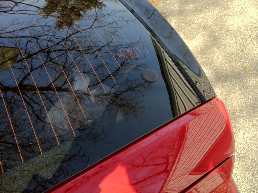

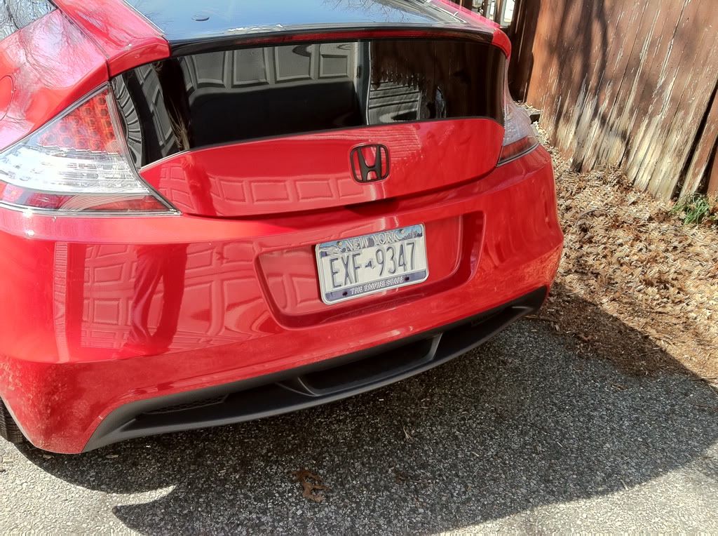

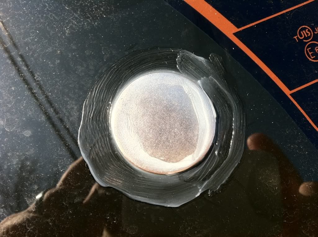

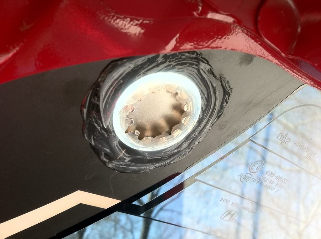

Here's a few pics of my wiper delete mod.
For more info, check Hoi's DIY thread.
All I used was a 1-1/4" metal cap, clear silicone, and black plasti-dip from Lowes.
The metal cap fit in there nice and snug plus the clear silicone locked it all down.
The bottom pic show it on the top left. Thx again for the idea Hoi...:thumbsup:

Hi there,
if there is anybody else who wants to "really" clear the rear Window. Try to order a German hatch door. The CR-Z comes without a rear wiper in germany (Europe?)
I don't know if it is possible to get the german/european hatch door everywhere.
Hope you can see it on the picture.
