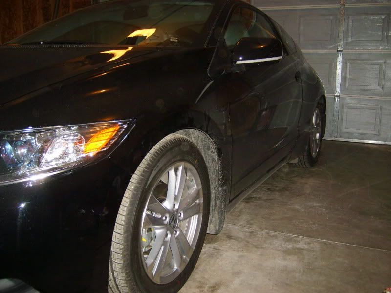

Wheel gap before:
Wheel gap after:

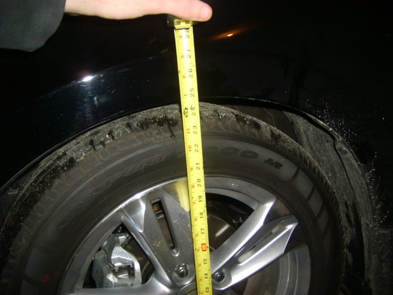

Fender height before:
Fender height after:
You might notice on my fender measurement, before it was just under 26". After install and some driving around to settle the springs, I am right at 24.5". Perhaps my measurements are not exact, but this still looks more like a 1.25-1.5" drop. These were both measured on the front left fender.

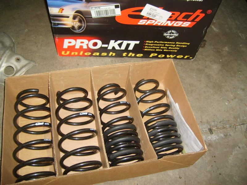

I ordered my springs directly from Eibach, and they were at my door less than a week later. The quality looked pretty top notch to me.

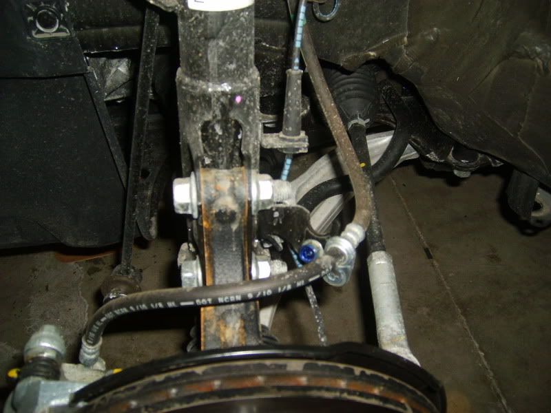

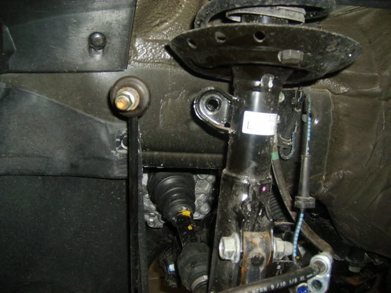

The removal and installation of the front coilover assembly is a piece of cake. You simply unbolt the brake line bracket... (12mm)
and swaybar endlink... (14mm) but be cautious, both front wheels must be lifted off the ground so that the swaybar is not pre-loaded! (almost learned that lesson the hard way)
unclip the ABS sensor from underneath the bracket, I used a screwdriver...
and remove upper (17mm) and lower (19mm) shock bolts. Mine did not require use of a hex key on the top, but they have small rubber covers on the top of the bolts that you need to remove.

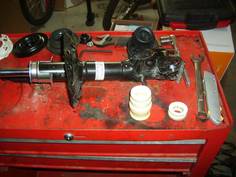

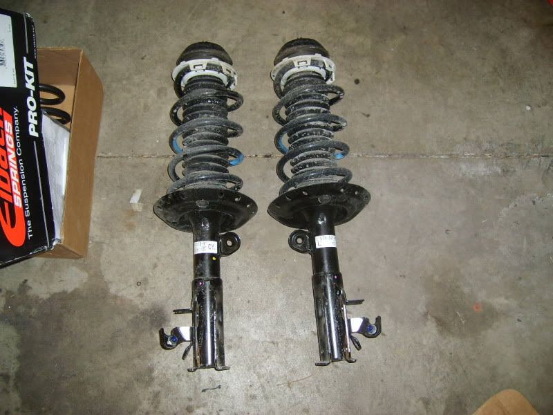

Next you would use the spring compressor to free up the top hat, then use a hex key and 19mm wrench to unbolt it.

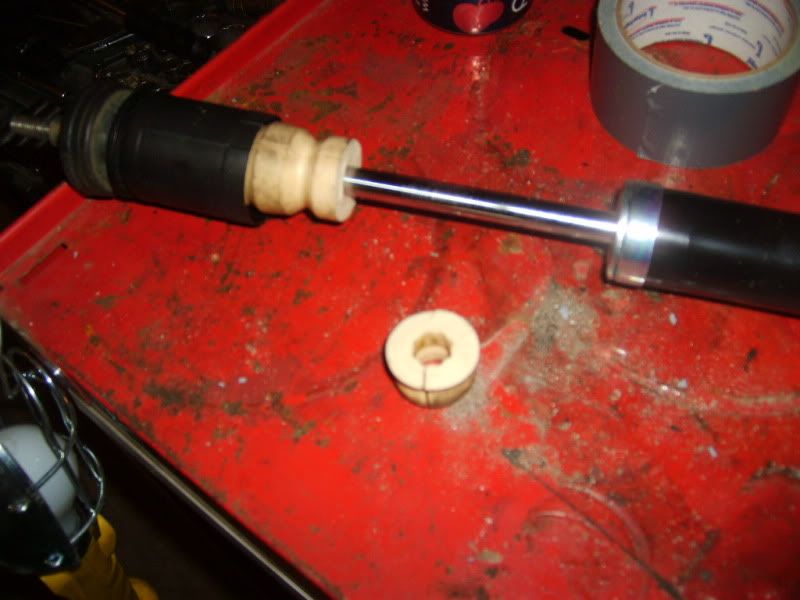

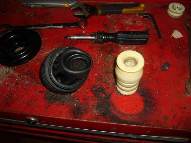

The tricky part is removing the bump stop from the top hat in order to cut it down, and then reinstalling it. When snapping the white plastic part of the top hat off of the metal, I slipped and gave myself a nasty cut on my thumb. Wear gloves when doing this!
After cutting about 1" off the bottom of the bump stop, I struggled for a while to get it back into the dust cover and top hat. Ended up cutting a small sliver off of the ridge that holds it into the top hat, in order to get it in securely.

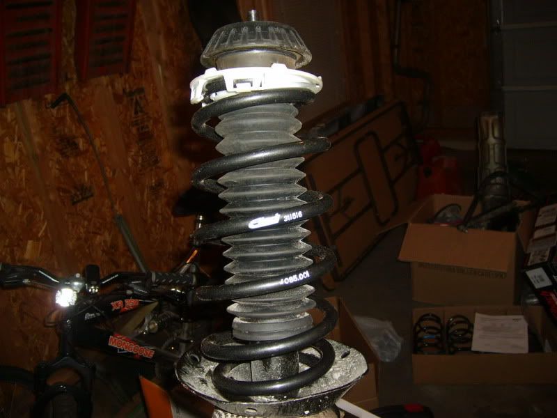

You would then reassemble the strut with the Eibach spring. The instructions state that the word "Eibach" should read right side up. The top hat and spring seat have nice indentations in them that show you where the end of the coil will line up, so you don't have to worry about marking their orientation.
Reinstalling the strut assembly is reverse of the removal. I did the lower shock bolts, then the upper, followed by swaybar, brake line and ABS sensor.

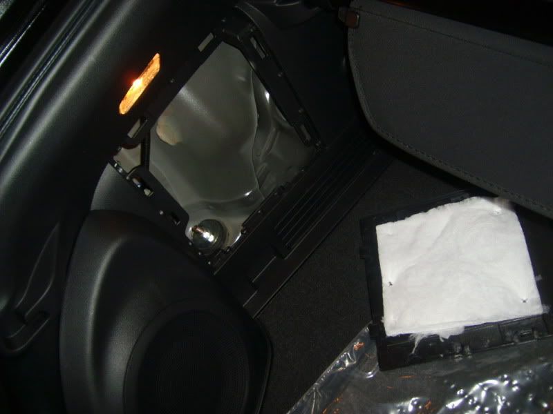

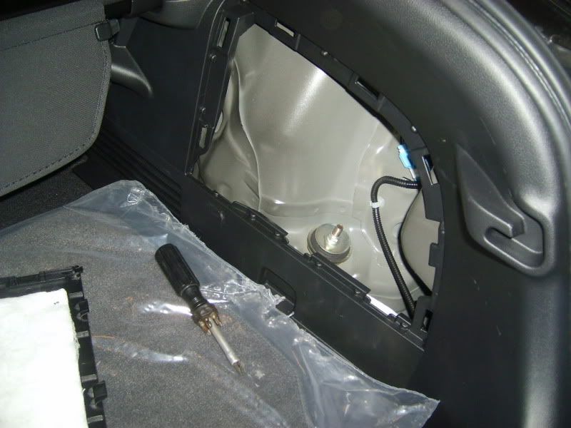

You will start by removing the two rear side panels in the back hatch area, which cover the top shock bolt. There are small indentations toward the top front side of these panels where you can insert a flat head screw driver and gently pry away the clips.
You will then remove the upper and lower shock bolts (both 14mm) and the upper will most likely need a hex key also.

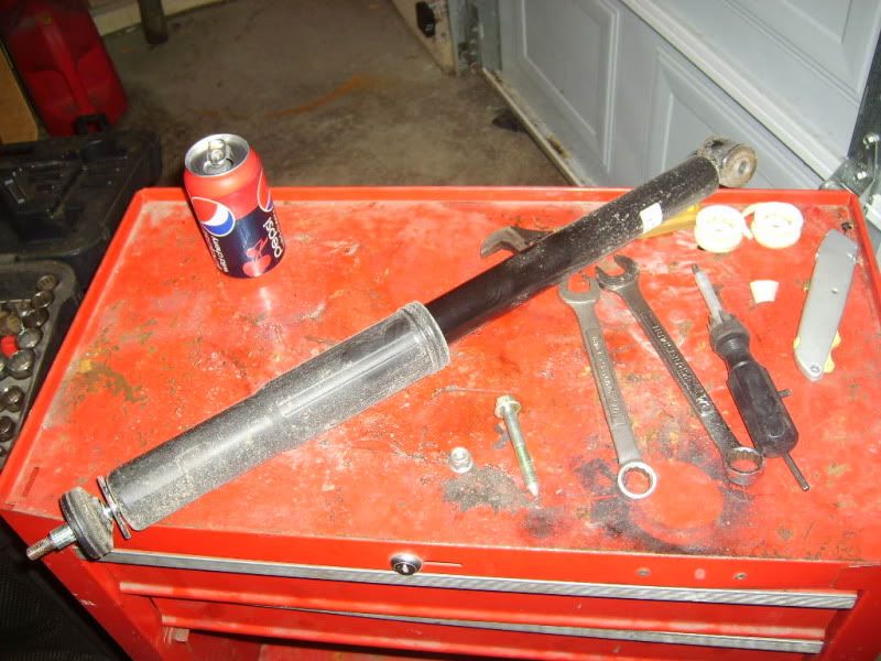

Here is the rear shock removed:

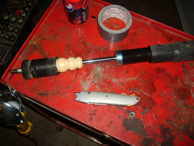

The Eibach instructions say you can drill out a pinch point on the washer that holds the top collar and bump stop in place, however on my car the long washer had a ridge all the way down that prevented it from being drilled out. So I had to use the method of cutting the dust cover to reveal the bump stop...
Then cutting about 1" off the bumpstop while still on the shaft.

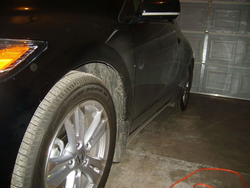

Okay so I got home from work, rushed outside to wash the layer of salt off my Z despite the 30 degree temperature, and it was already getting dark by the time I started taking pics lol. But its going to rain the rest of the week, so this is the best I could get for now.
