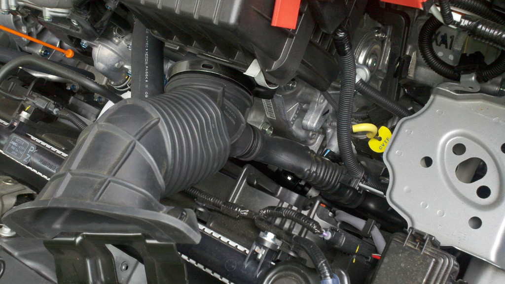

BLF CAI pics
Intake to resonator
As seen below the intake is connected to this plastic glob below.

The resonator
Here is the beast removed. I pulled all the rubber grommets off to make it easier to pull out. You can see here where all four bolts are located.
