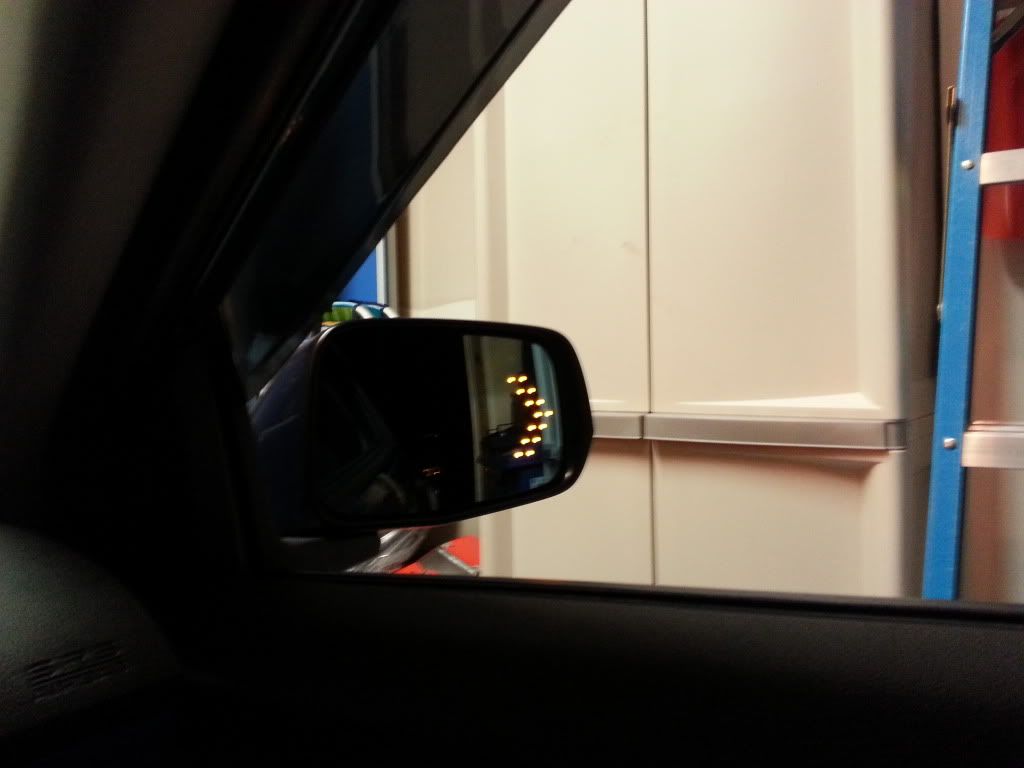

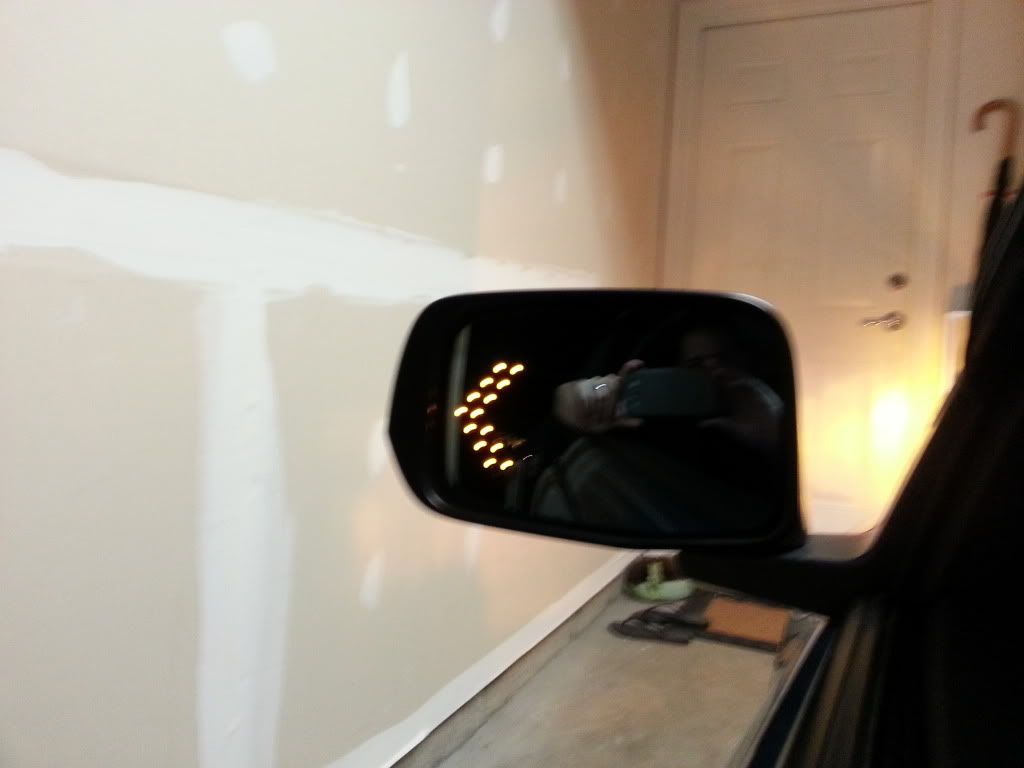

Test the turn signal and heater (turn on your rear defrost):
If everything tests fine, (also test the mirror motor), mount the new mirror into the housing. Peak under and align the top clips with the slots and swing the mirror down. There are 4 tabs left to push in. Make sure you hear them click in.
