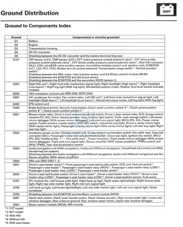

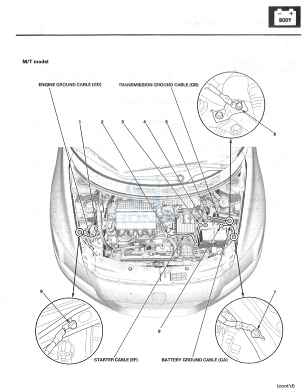

Nice to share the ground wire diagrams d1giPhux. Check all those grounds and make sure the bolts securing them are tight.

Couple more charts that may help you out:
Ground Locations (see HID section for headlight):
Relay locations:
Wire Harnesses in the car (shows more ground connections circled and enlarged):
Oh yeah, and forgot.. these will help you identify locations as well. The wire harness index for all that stuff!!:
