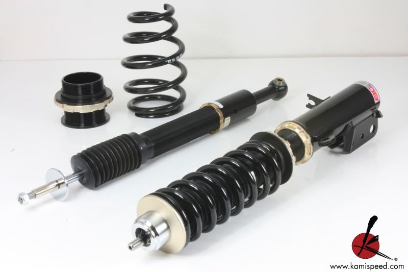

BC Racing BR-Type Coilovers
Front: 4 kg/m Rear: 5kg/m
Adjustability: Yes - 30 levels of damping force adjustment, adjust compression/rebound
Damper: MonoTube
Drop: Untested Yet
Price: MSRP $1250
Rebuildable: Yes
Other information?: BC Racing - North America ; Also available in "RAM-Type." These coilovers are basically the same thing except they're inverted-monotube, MSRP prices are also more expensive at $1450.

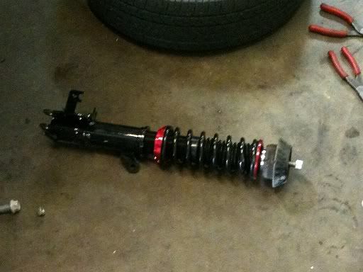

Corner Konnection C1
Adjustable: Yes
Damper: Mono Tube
Spring Rate: Custom
Drop: ?
Price: $1800.00 (intro price available as of 5/4/2011)
Mounts: reuse stock
Rebuildable: ?
Other: Only available from Tony at Basis Sport Tuning as of now. Custom valved and custom spring rates on the coilovers. Picture is generic not the actual product for this application
PICS Courtesy of GoTuning a forum vendor. Full suspension install instructions in the DIY section
