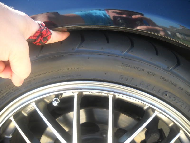

i run the Mugen SS setup on the rsx and love them. but im more than upset by a -15mm drop!!! mine are -40-45mm which i think is ideal for a daily driver

oh sweet! what i did to reduce the remaining wheel gap was upgrade 1 size on tire *from 225/40/18 to 235/40* it put the speedo off 1.2mph at 60, but rides better and is 8mm wider

@ vash, what's your drop? And wheel size?

I would say a little over an inch
18x7.5 Enkei Rpm2's
Nitto NeoGen 235/40/18
looking nice vash
