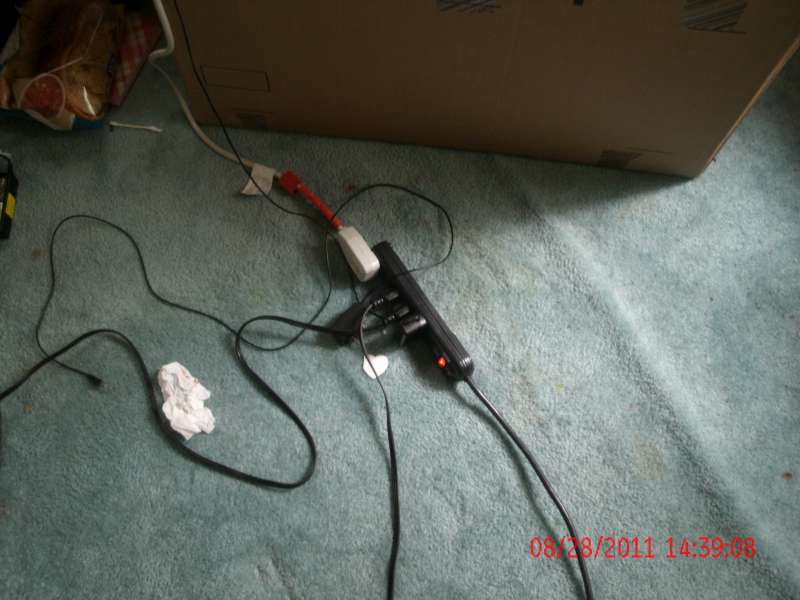

So, I have my CR-Z idling with about a 45 amp 12V load on it from a high power DC-AC inverter running some lights and other odds and ends in my house... odds and ends being my laptop, cell phone chargers (for wifi tether since my cable modem won't link up... I assume the local hub is down too...), 40" LCD TV, PS3 (watching some blurays), window A/C unit with just the fan running, speakers, etc.

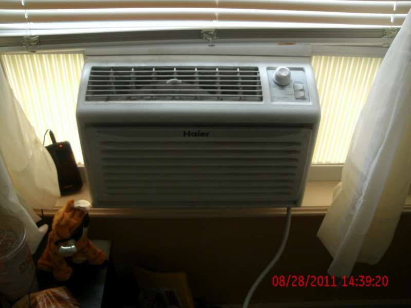

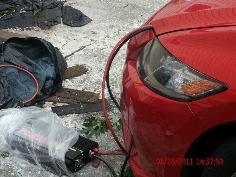

I did um... *try* to fire up my little window A/C unit... the invert can handle it (2000 watts peak... and I've run it at 1800 watts steady) but, the 'Z couldn't supply the juice to get it going. Might be that the run is too long on the DC side to the inverter... I have 2 gauge wire from the battery terminals running to the inside of the house where the inverter sits.

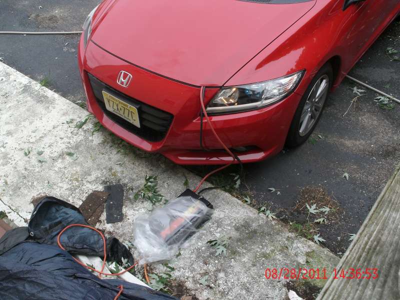

I did a better connection job this time and I'm currently drawing just over 60 amps at 12V without breaking a sweat. Was able to fire up my little window A/C unit AND the refrigerator in the kitchen with no problems. I'm pretty impressed.

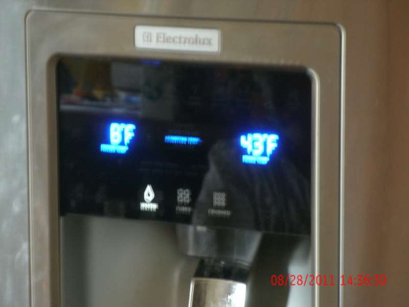

Refrigerator was up to 22F in the freezer and 59F in the fridge when I plugged it in. See the pics and its down to 8F and 43F respectively after an hour or so.

Didnt take a pic of the Kill-A-Watt this time, but, AC draw is just over 625 watts right now, with some peaks over 1000 or so when the A/C kicks off/on.

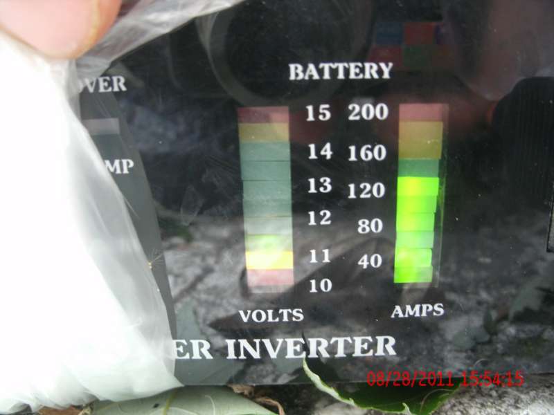

Holy amps, Batman...
So, I peaked out at a steady 120 amps (~1400 watts) before the 12V system on the CR-Z started to really sag. (Down to 10.5v)
Back at a steady draw of about 75 amps with no major sag.

Cool posts... thanks for putting them up. If you get the chance, a photo of the inverter's connection to the car would be great.
