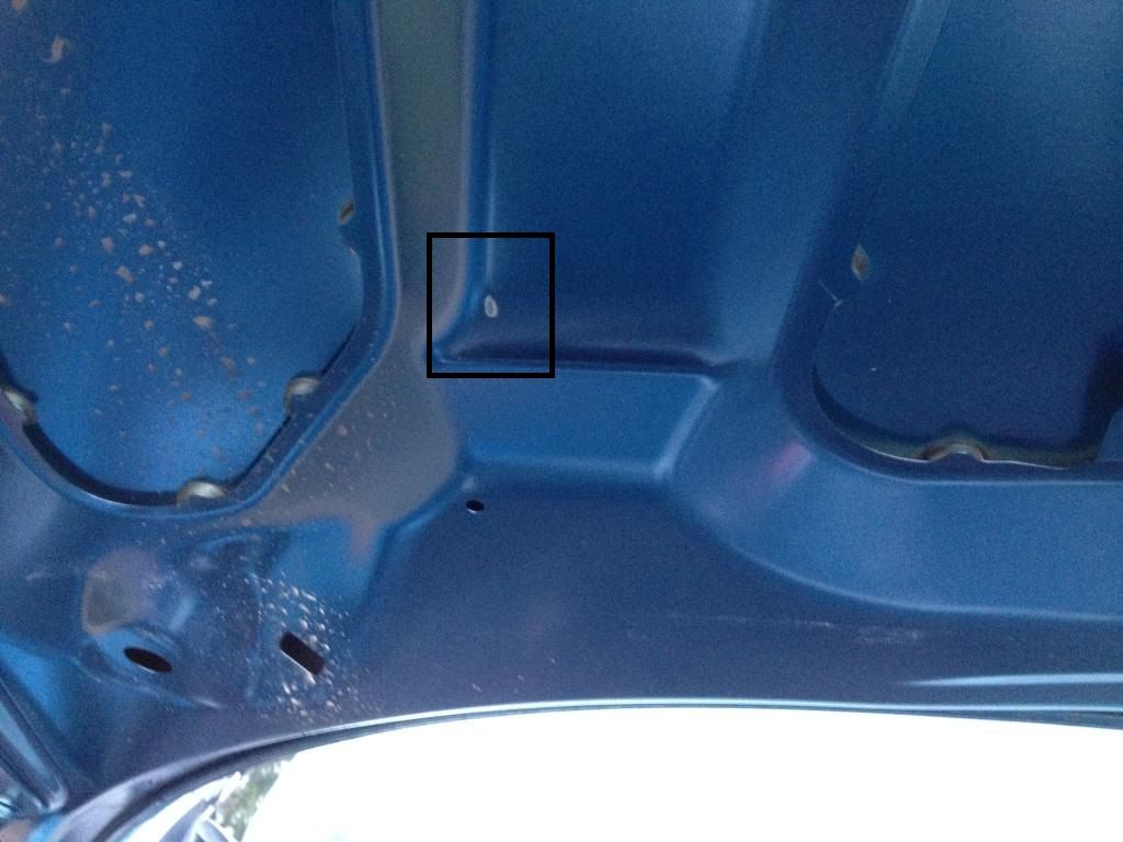

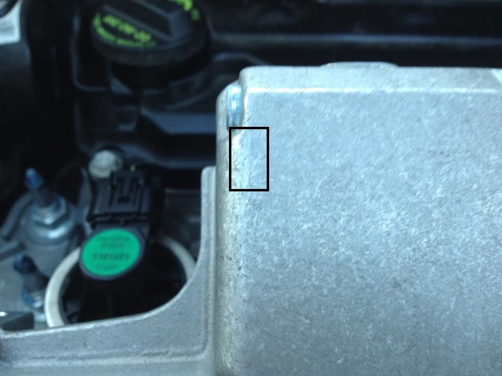

Took a better picture of where it's making contact on the hood and where the blower makes contact...
